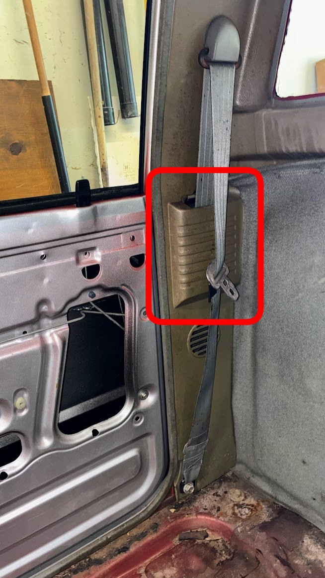

The vehicle is my '83 P’up. I replaced my bench seat with buckets, and now I need to replace the seat belts with a set from a bucket seat equipped vehicle. Otherwise, I have to fumble around the floor to find the buckle every time I get into the truck. And my originals are worse than grungey. At first (over on that other site) I was looking for only the inner (receiver / female) ends, thinking I’d keep my original belts. I learned that the ones from the Trooper are not as wide, and thus the buckles are not compatible. I’ve also explored an aftermarket replacement from seatbeltsplus.com. It looks good, but it is designed for the retractor to mount on the floor. The P’up has it mounted on the side post, just below shoulder level (maybe 18" above the floor. The guy at seatbeltsplus.com told me that theirs should mount just fine there, but that it might not retract enough to take up the additional 18" of belt.
So I’m back to looking at Trooper seat belts – not the inner receiver pieces, but the whole set. I’m trying to determine if I can swap it all.
So, question: Does the 1st generation Trooper have its retractor mounted midway up like mine (pictured below), or is it mounted on the floor?

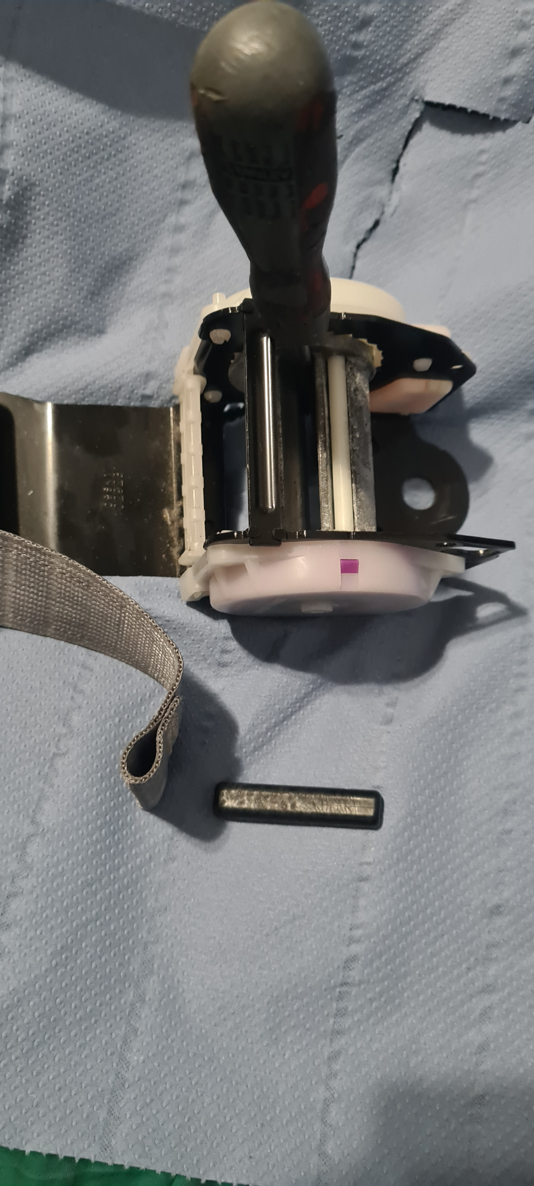

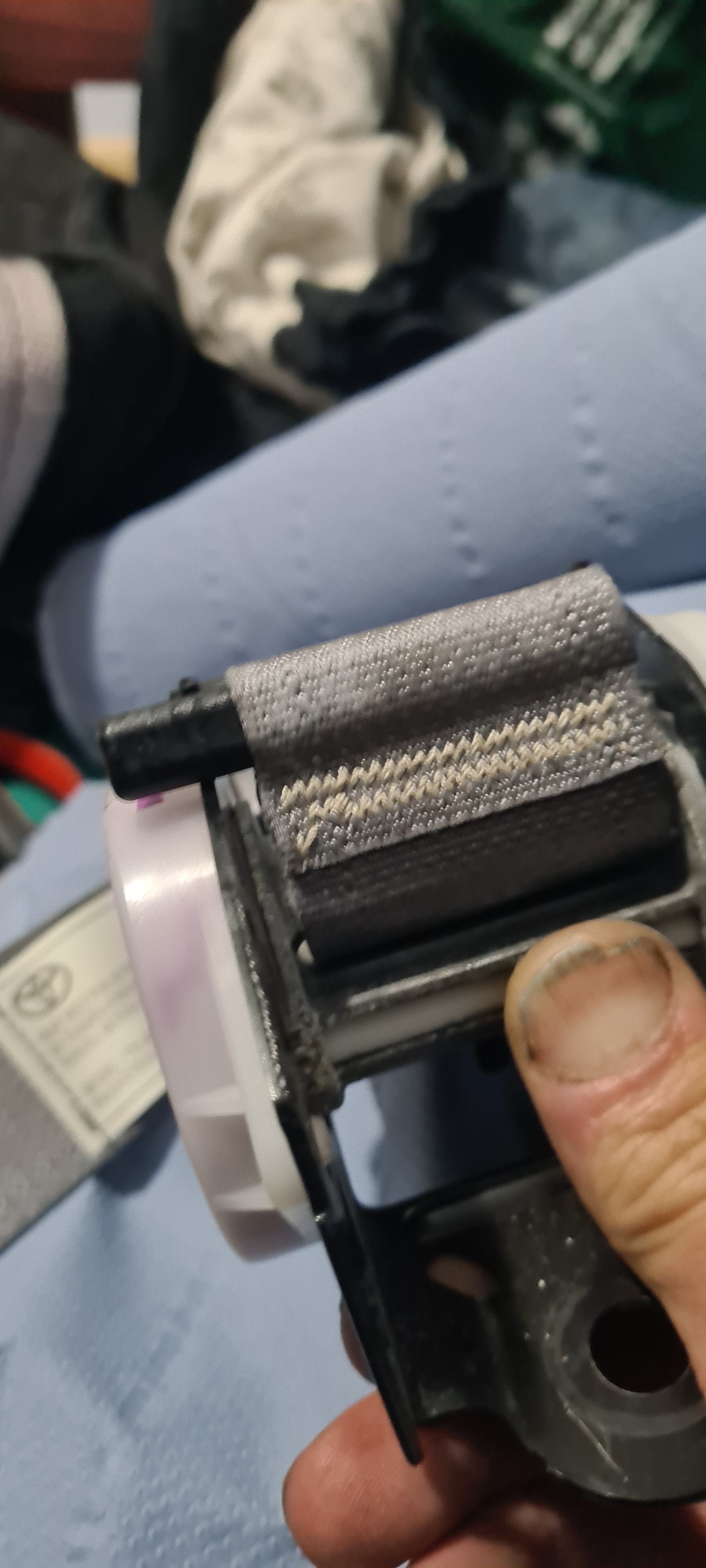

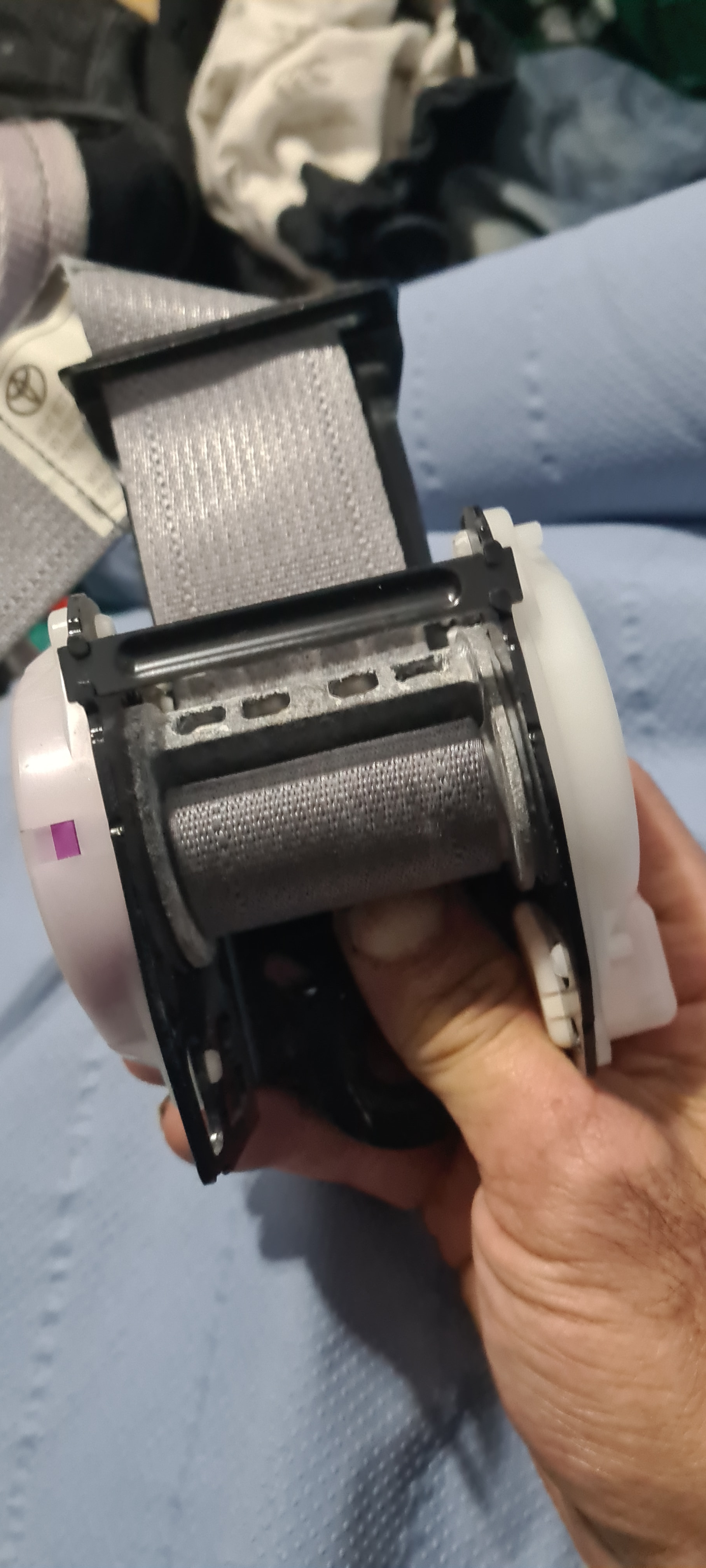

You can put more pretention on the retractor spring by unrolling the belt to the ‘drum’ Remove the belt retaining Bar thingy then turn the drum a few more turns then putting the belt back on..
Infact.. If your units aren’t in bad shape, you vould just insert the ‘new’ belt onto your retractor mech..?
I don’t think pretension is the issue. I believe the retractor doesn’t have enough room for any additional belt material.
And my belts are just super-grungy – I’m surprised they’re not rotten. Maybe they are.
@lowzone, are you seeing this?
Sorry, i mean, Remove the grundgy belts OFF your retractors..
Keep existing Retractors and replace the belt material..

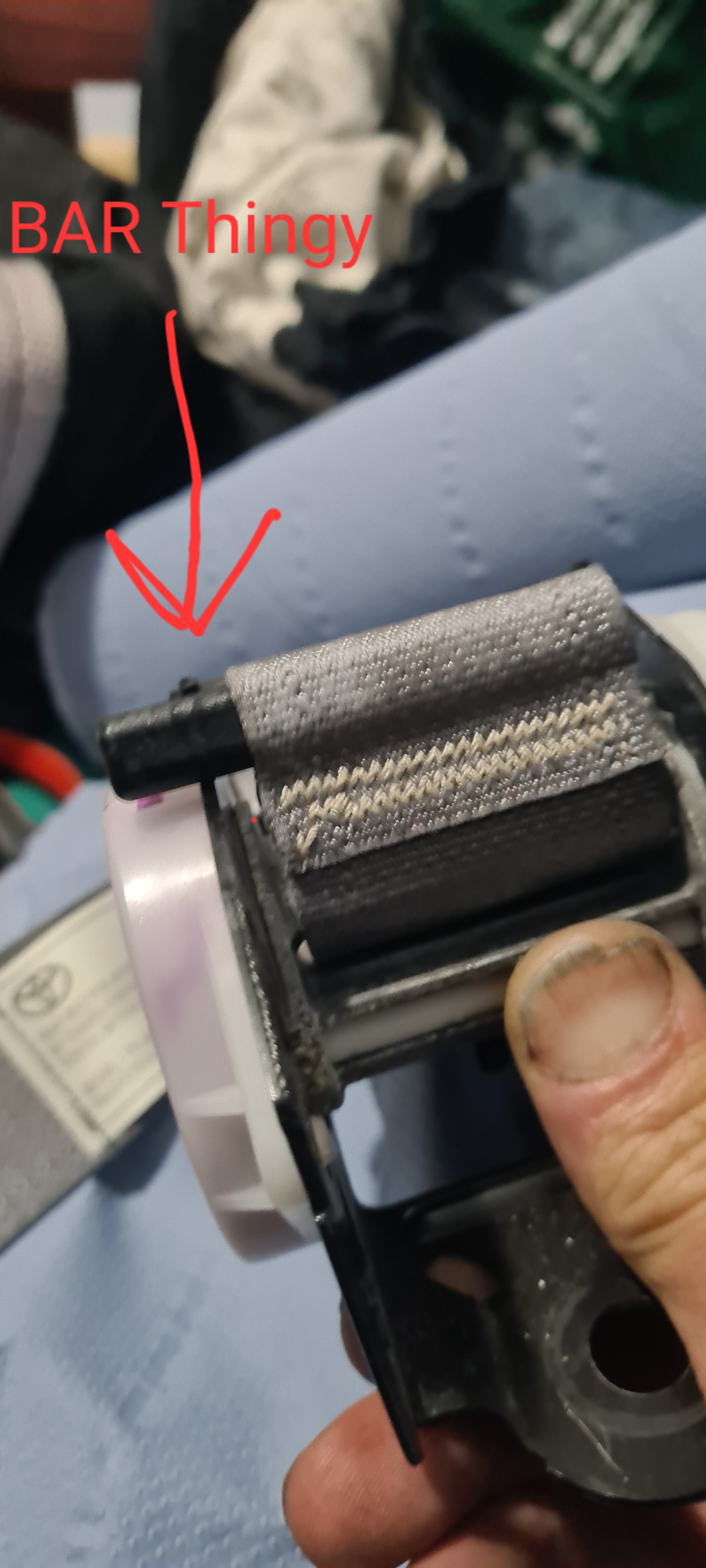

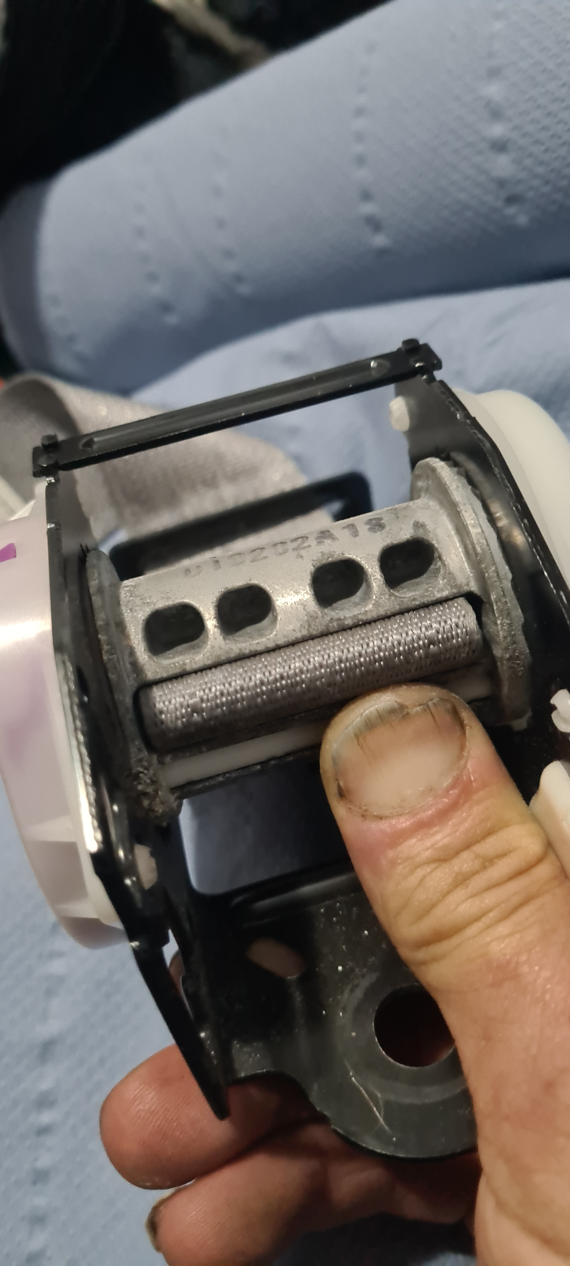

The belt Basically attaches to the retractor much like a Truck tie down strap…
It feeds through the drum and retained with that bar thingy..
Belt removed…
Screwdriver holding drum from unloading spring..
Just pull one apart…
You’ll understand way easier than I can explain..

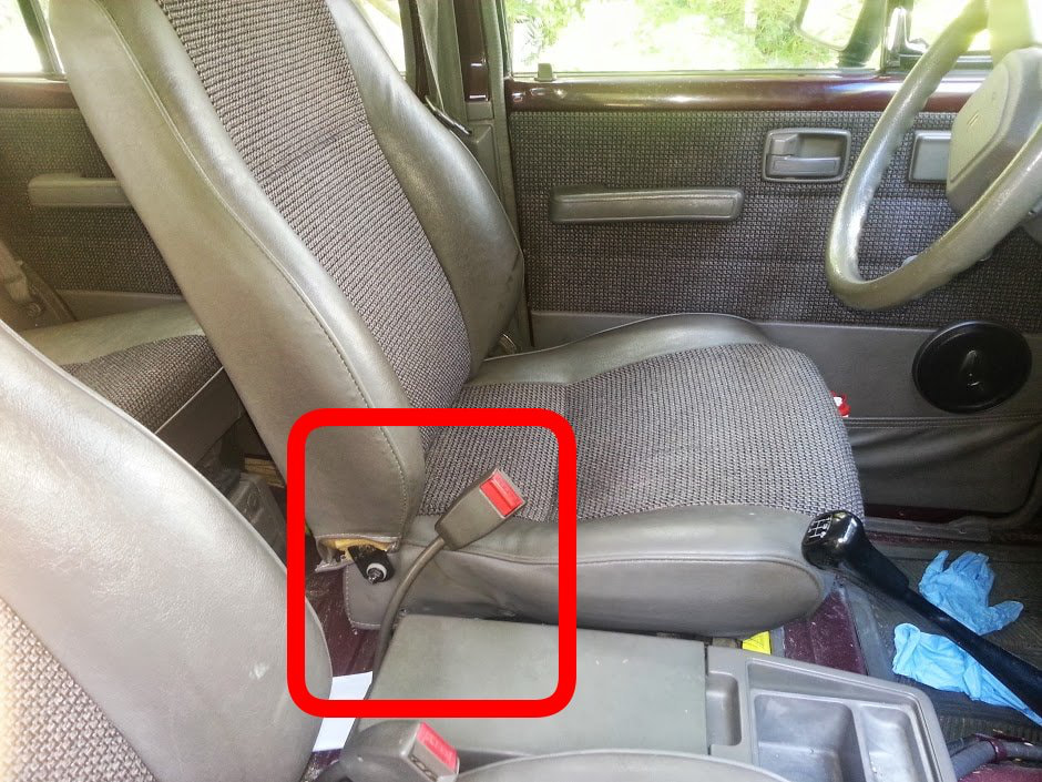

1st gen Troopers had a stalk mounted buckle. I want that.
Unfortunately, the picture of it is in the original discussion on the site some of us are banned from. :laughing: Oh, I just remembered, I also posted it in isuzupup.com. Here’s what I want:
But my belt won’t fit this buckle, so I’m looking for the whole assembly.
Okay, I think I’m tracking. I think all my suggestions are going to be alternatives for if you can’t get what you want from putting together factory parts. My first suggestion of a belt guide, was in reference to that part. A loop attached to the seat, just to help locate the buckle.
To answer your original question Jack:
Yes, the 1st Gen. Trooper retractors are mounted halfway up the pillar.
