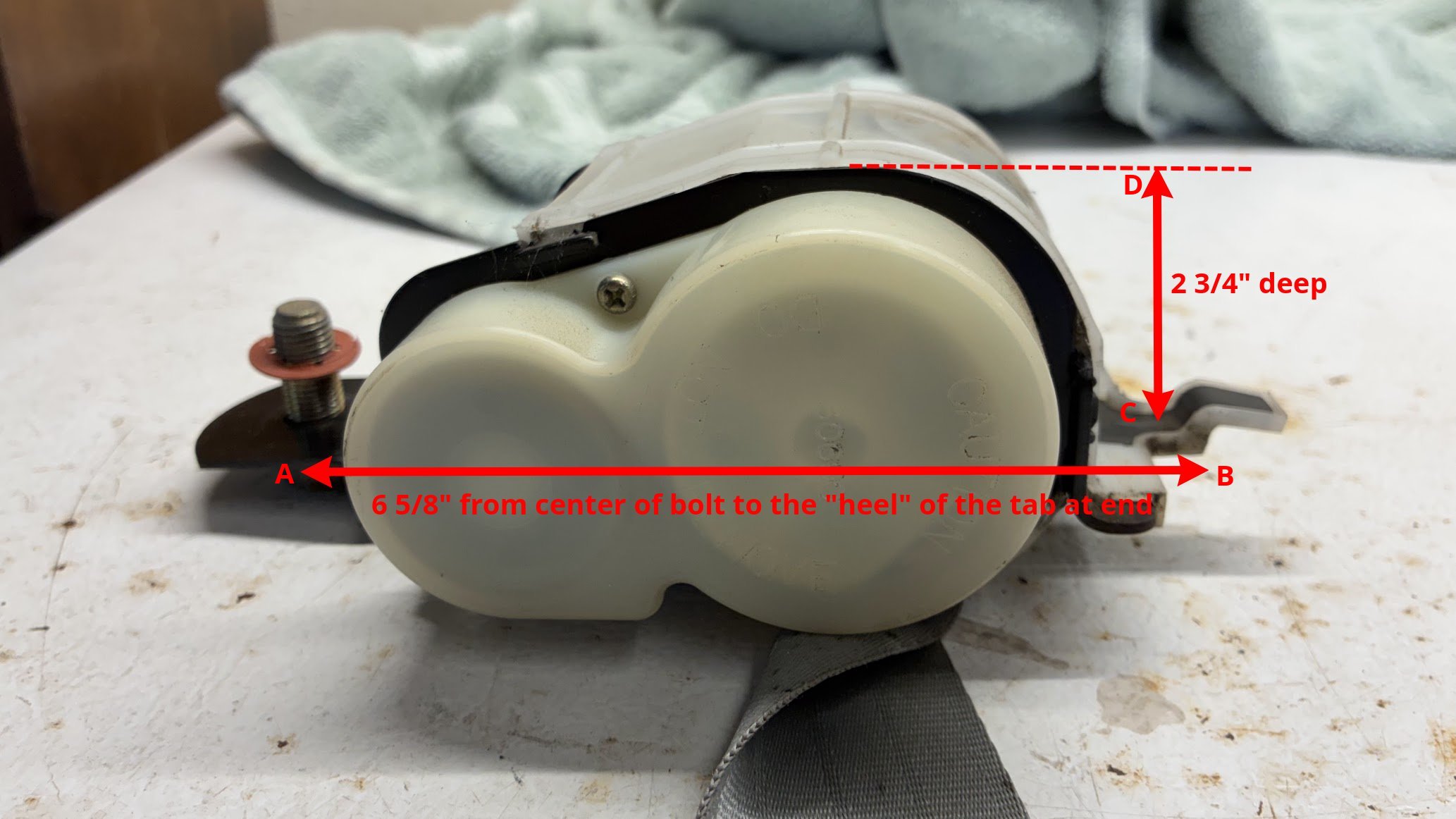

I had a long talk with Paul Catalano today (there are no short talks with Paul :joy: ). We compared the 1983 P’UP seat belt retractor to the 1988 Pickup retractor. They are not interchangeable – too long from point “A” to point “B” (see below).
So I am hoping the 1st Gen Trooper seat belt assemblies will interchange. Does anybody have a set of these in grey?

That would be great, Mike. I’m pretty sure the depth will be fine, it’s the length that seems to vary from one generation to the next.

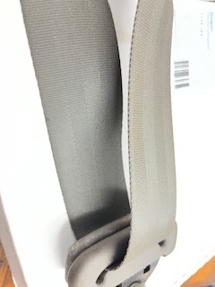

Trooper retractor matches your dimensions exactly. It’s 3 1/2"wide. The lower belt mounting bolt is appx 2" off the floor. The upper belt mounting bolt is appx 39" off the floor. The belt will extend appx 5’ from the retracted position. Trooper seat sits appx 11" above floor. That’s at the point about 5"-6" in front of the seat back, where your butt sets. Hope that makes sense. Look like your color? Post preview doesn’t show pic, hope it goes through. First time I’ve tried on this site.
