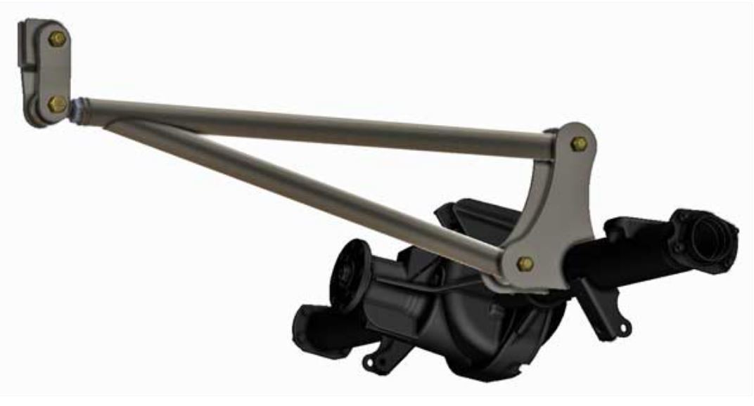

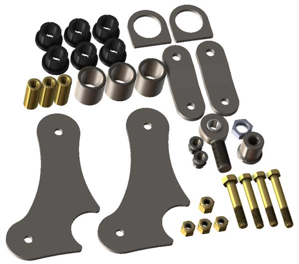

An anti-wrap kit such as this might do the trick:
It does require some fab work and welding. But looks well-built, and reasonably-priced.

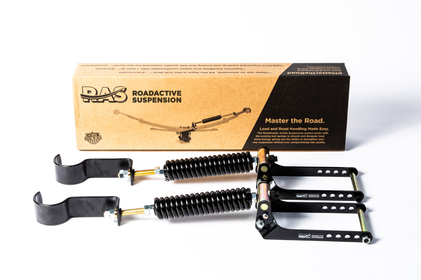

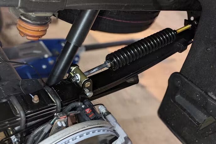

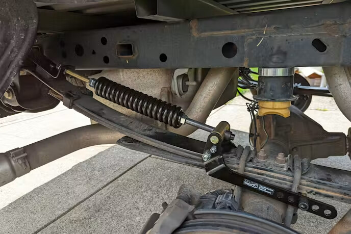

Antother interesting bolt-on spring-type towing support:
You might have to contact the company to see if thise would work on a smaller rig, as generally it’s meant for full-size trucks that are towing a heavy load.

Those spring ones are kinda interesting..
They seem to be aimed at helping with payload but the way they are mounted, it would resist ‘wrapping’..?
The single centred one I couldn’t use because of the Trundle Tray..
I’m going to source some bango spherical joints and go from there I think..
