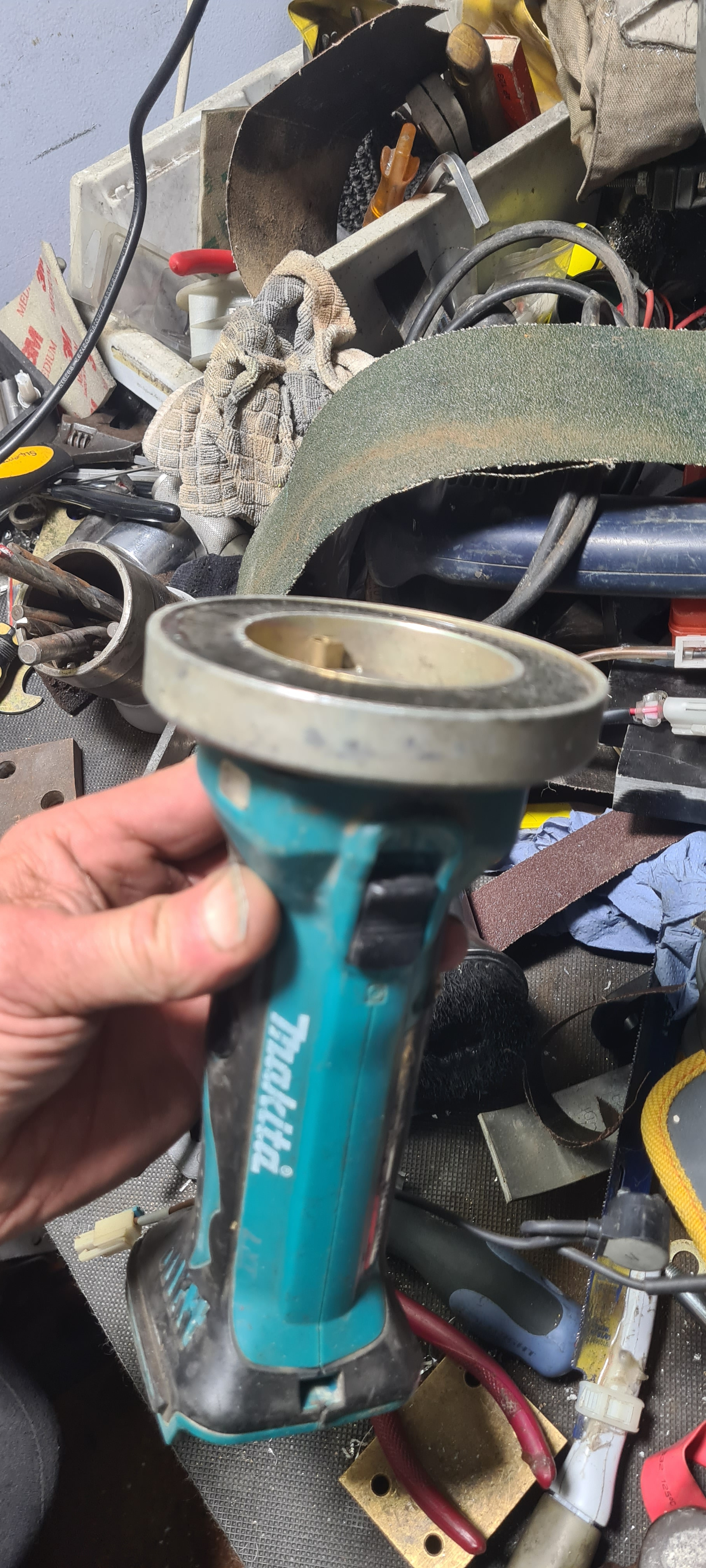

Those Electro Magnet’s work better than a dust brush for metal shavings..
I shit you not.

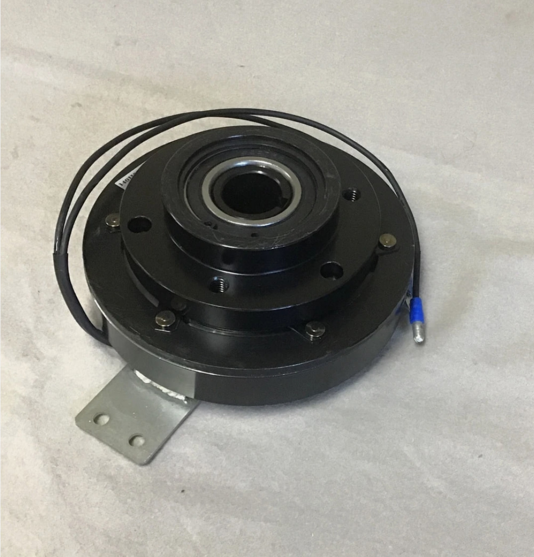

So I started digging… And found a simple through shaft on-off clutch, with a face mounted drive. All that needs to be done is make or modify a shaft with a flange on it, just like the original fanclutch, and make a flat plate flange adapter between the fan blades and the clutch face.
My only concern is weight, but I believe the reaction arm of the clutch can be used to also partially support its weight.

What is that unit off?

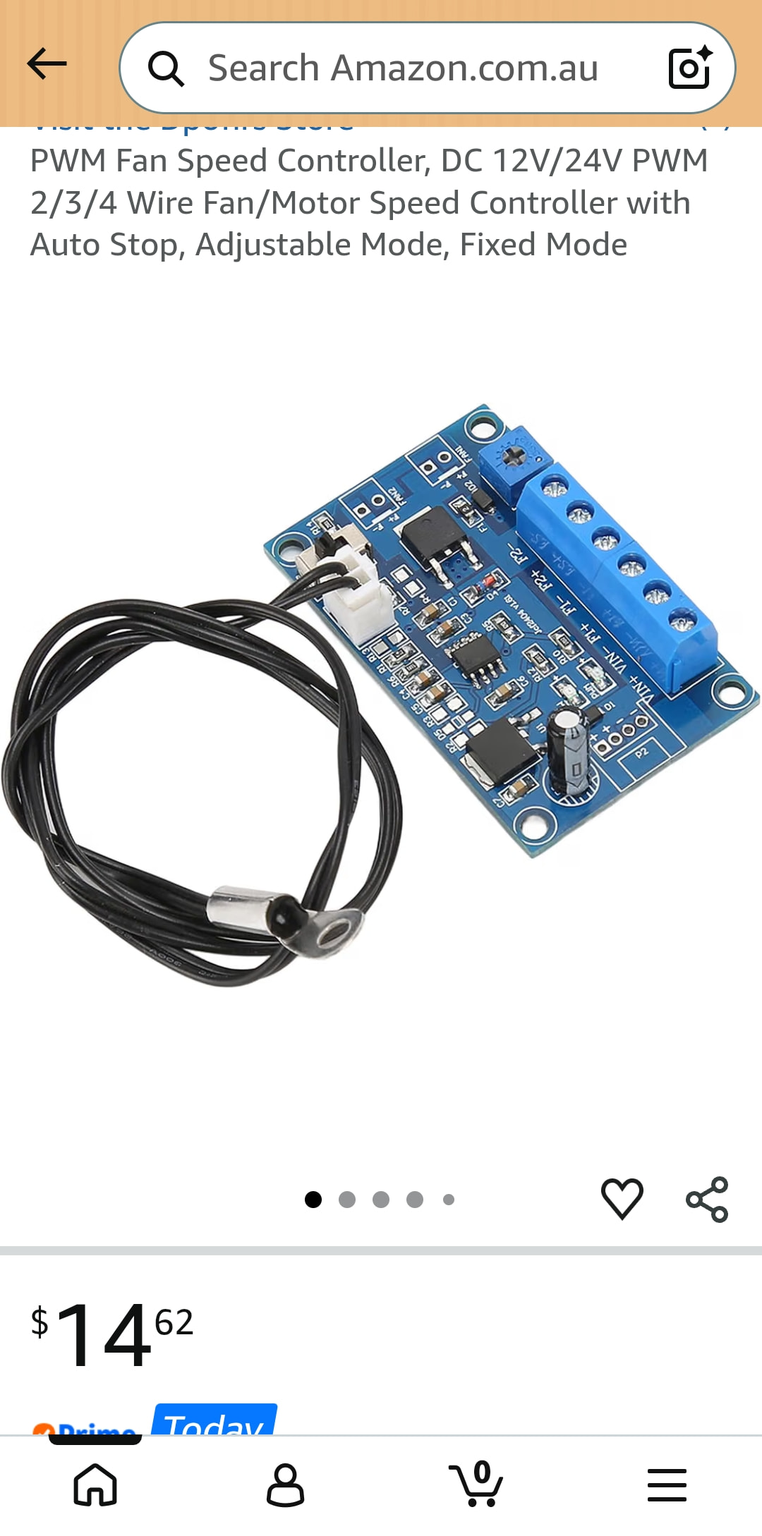

Have you seen these controllers on Amazon?
You can have it adjustable
Temp vs Fan speed or just fixed speed on and off.
I hadn’t. But not sure I trust $15 electronics with my engine’s life. Also not sure the signal would be the can for a PWM clutch or not.

It’s a salt spreader clutch.
