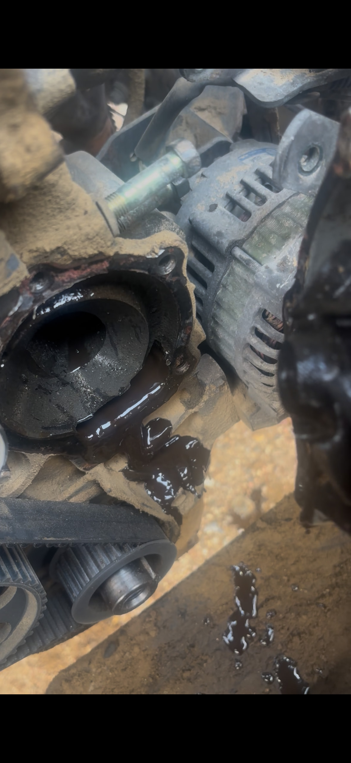

Bought an 88 trooper that sat in the Wyoming dust for 2 years without running. Owner tried to do maintenance then saw oil in the coolant and threw up his hands and gave up. So I managed to buy it with 190k miles for $600! We love the car and are willing to put a decent investment into keeping it alive. Should I assume head gasket is blown and go from there or focus on getting it running first?
After flush
Before flush
Yeah. You’re most likely looking at a head gasket. thing is, since you’ll be getting elbow deep in that you’re gonna wanna replace a buncha other stuff too while you’re at it or you’re just going to end up taking it apart over and over. Best to do it right, yknow?

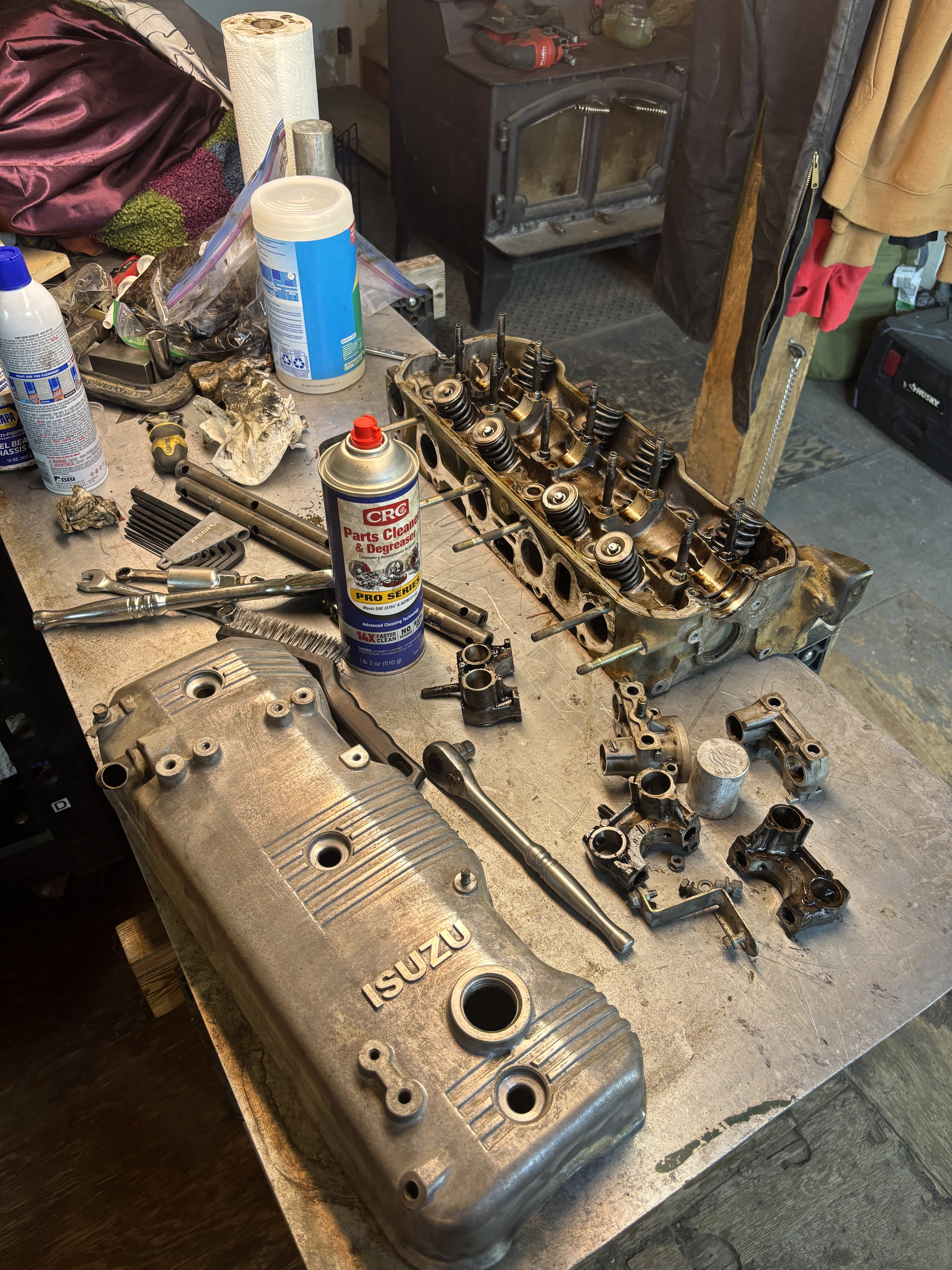

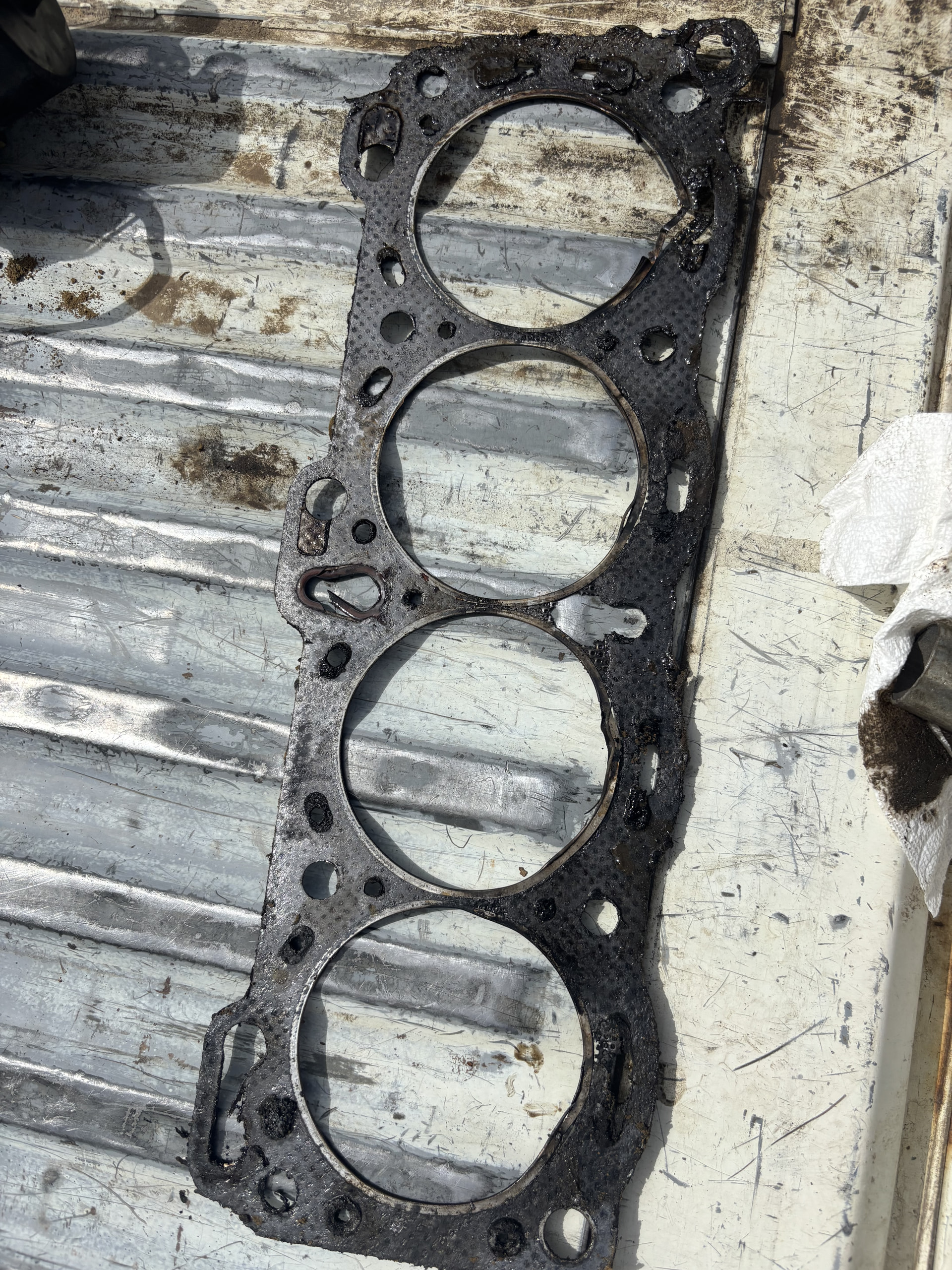

We have officially gotten the head off! A lot of dry rotted hoses that felt impossible to get off and little metal clips for the wiring harness that really sucked. That copper pipe behind the head for the EGR? Fuuuuuuuck that thing…. Only found out about the bolt and clip holding it on to the back of the head. Haha Stripped the exhaust side nut too. gonna try and figure that one out.

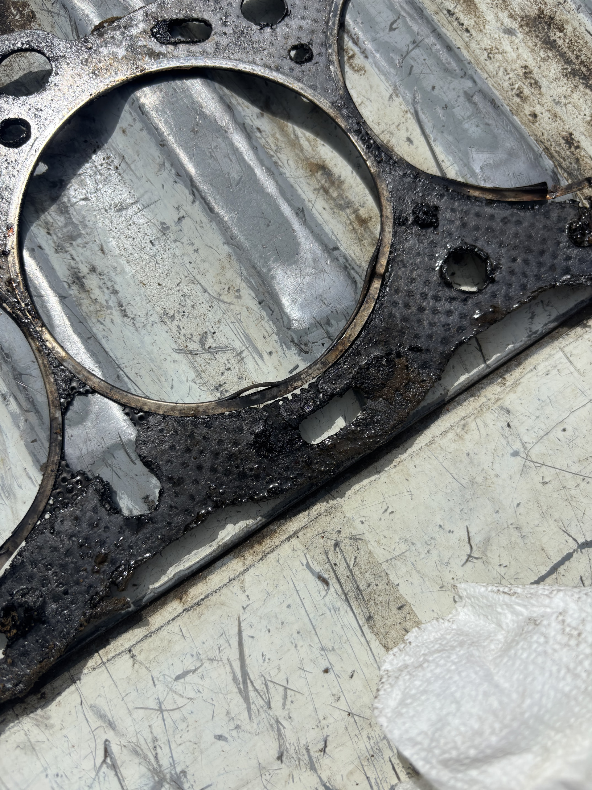

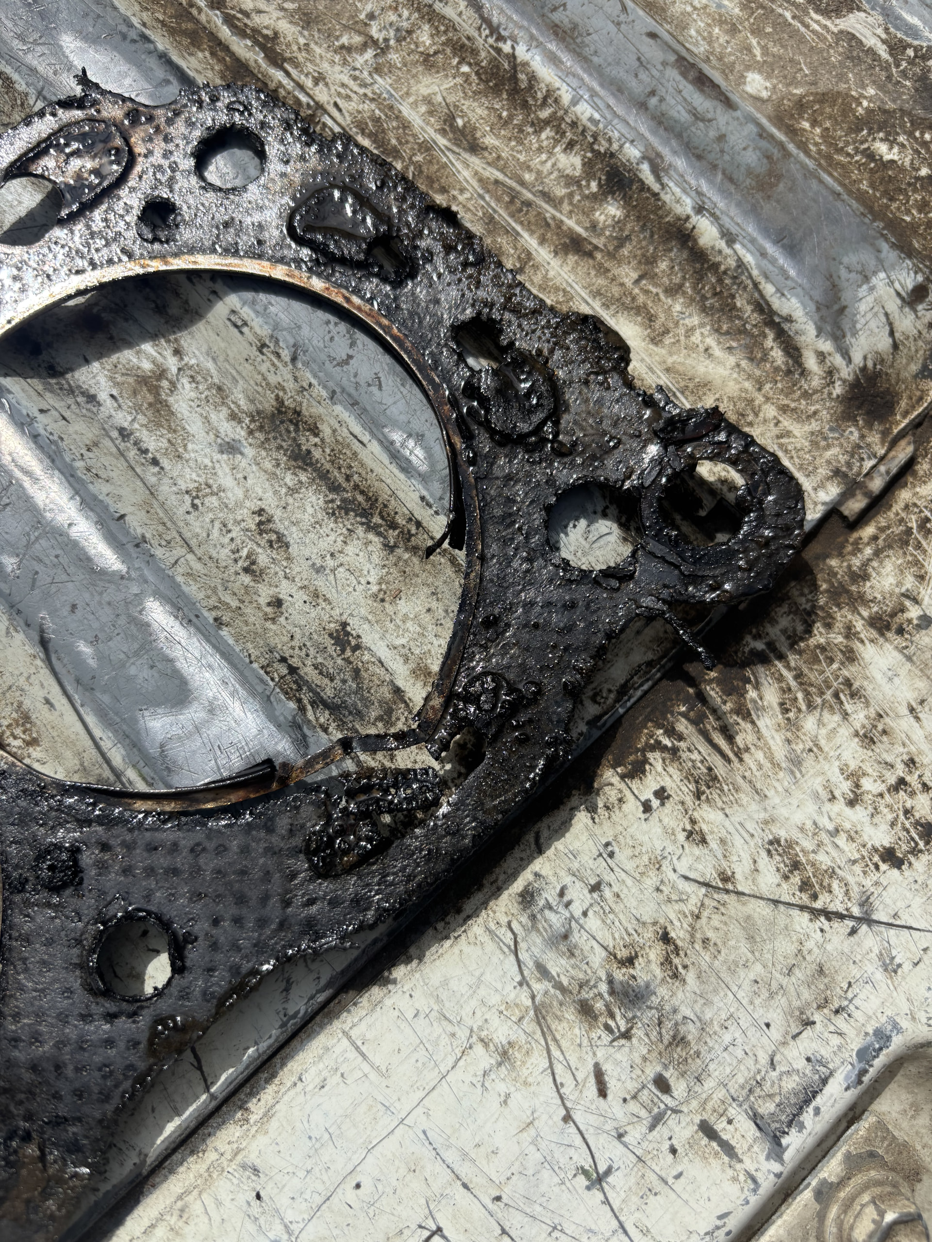

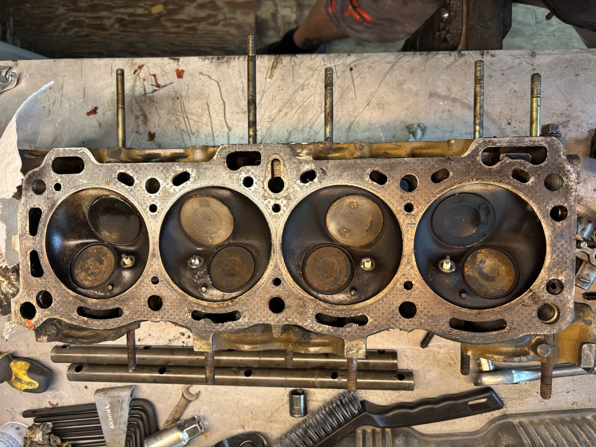

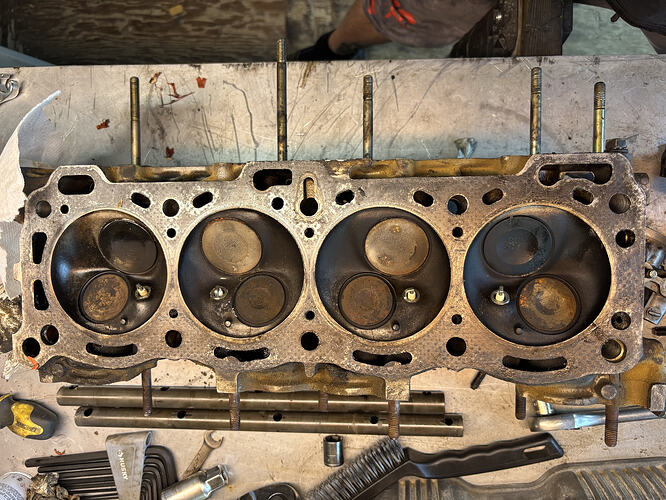

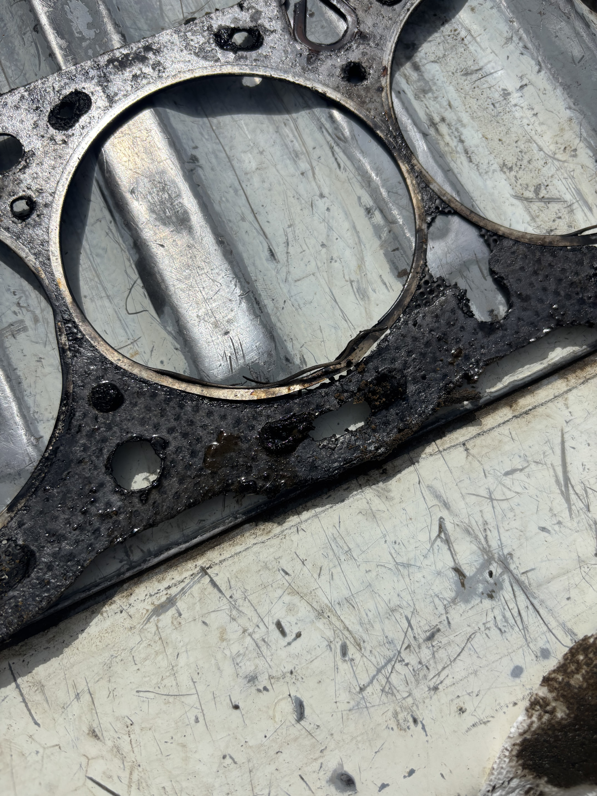

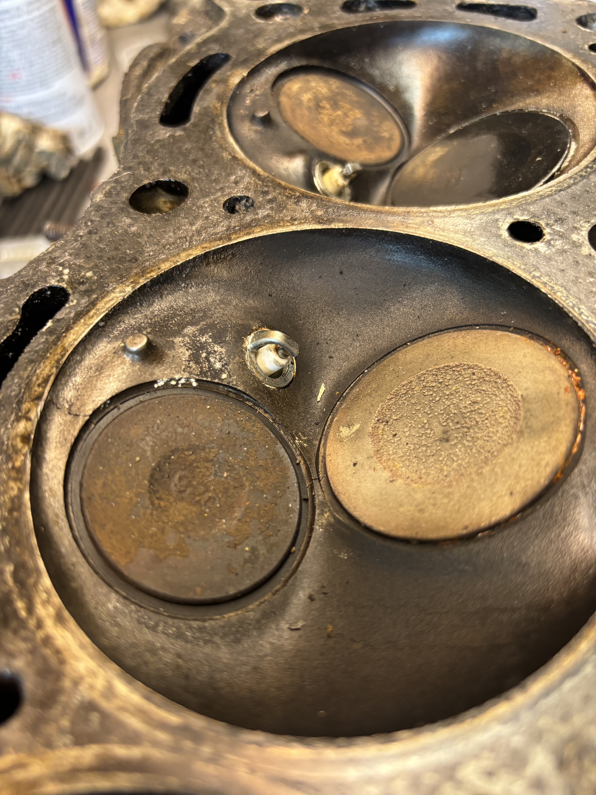

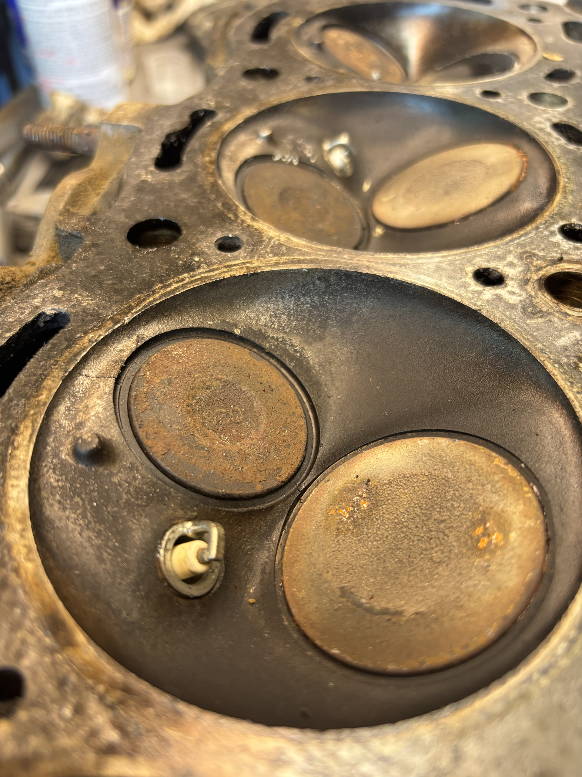

ANYWAY. Confirmed obliterated head. No need for a machine shop this baby is obviously cracked, warped and worked to the bone. Talked with the wife long before we got around to grunting our way through getting the head off but we are going to invest in the more expensive option.
Do you think cracks were first then warp then gasket destruction? Idk the state of it looks pretty bad. Water (obviously) in the pistons but it didn’t seem like the carnage on the piston walls as I was expecting to see.

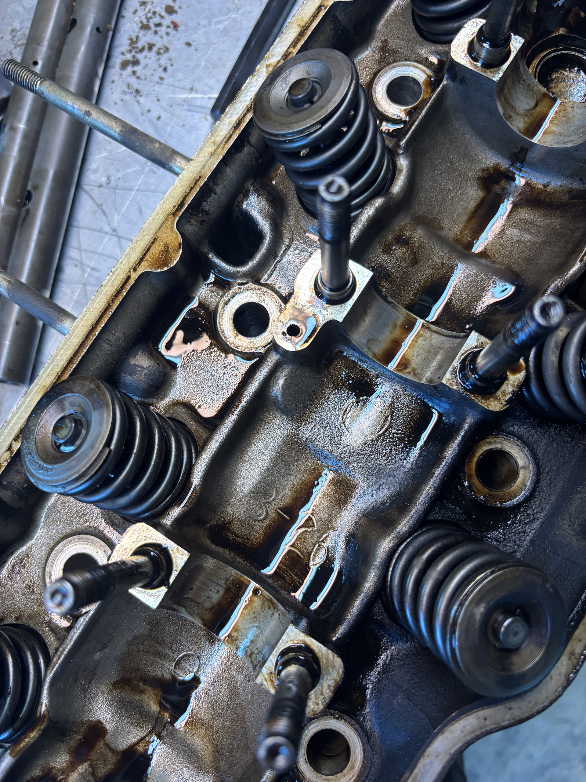

How much of this am I saving? Took apart all the rockers and took out the cam shaft. Valves themselves seem a little too blown to keep. But should I go through the trouble of taking the valve springs apart?
2+3 seem obviously the worst. How much attention should I give the block and piston heads?
Depending on the replacement head, you may need to re-use your rockers and rocker arm shaft assy’s.
