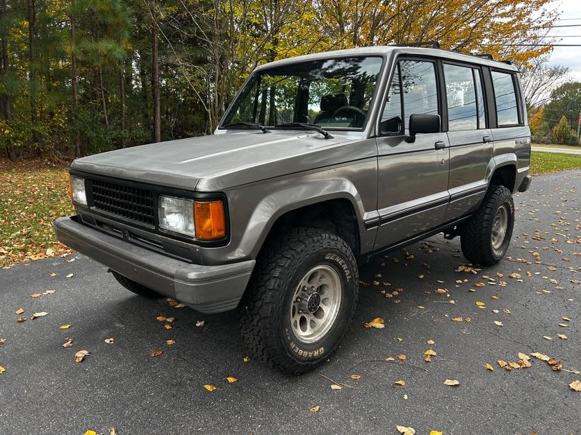

Some mornings it runs great, pulls great all the way through the rev range etc, other mornings / afternoons it really feels like its choked around 3k and falls over. One afternoon running through the hills, I had to bounce between 2nd & 3rd because I didnt have enough oooomph to keep speed in 3rd. As seen in the picture above, it has 31’s on it, jerry cam, and ~250 lbs of tools and camping shit in the back. I am getting ready to build my drawer system so the full camp setup will be ~500 lbs so I need to make sure its running like a top.

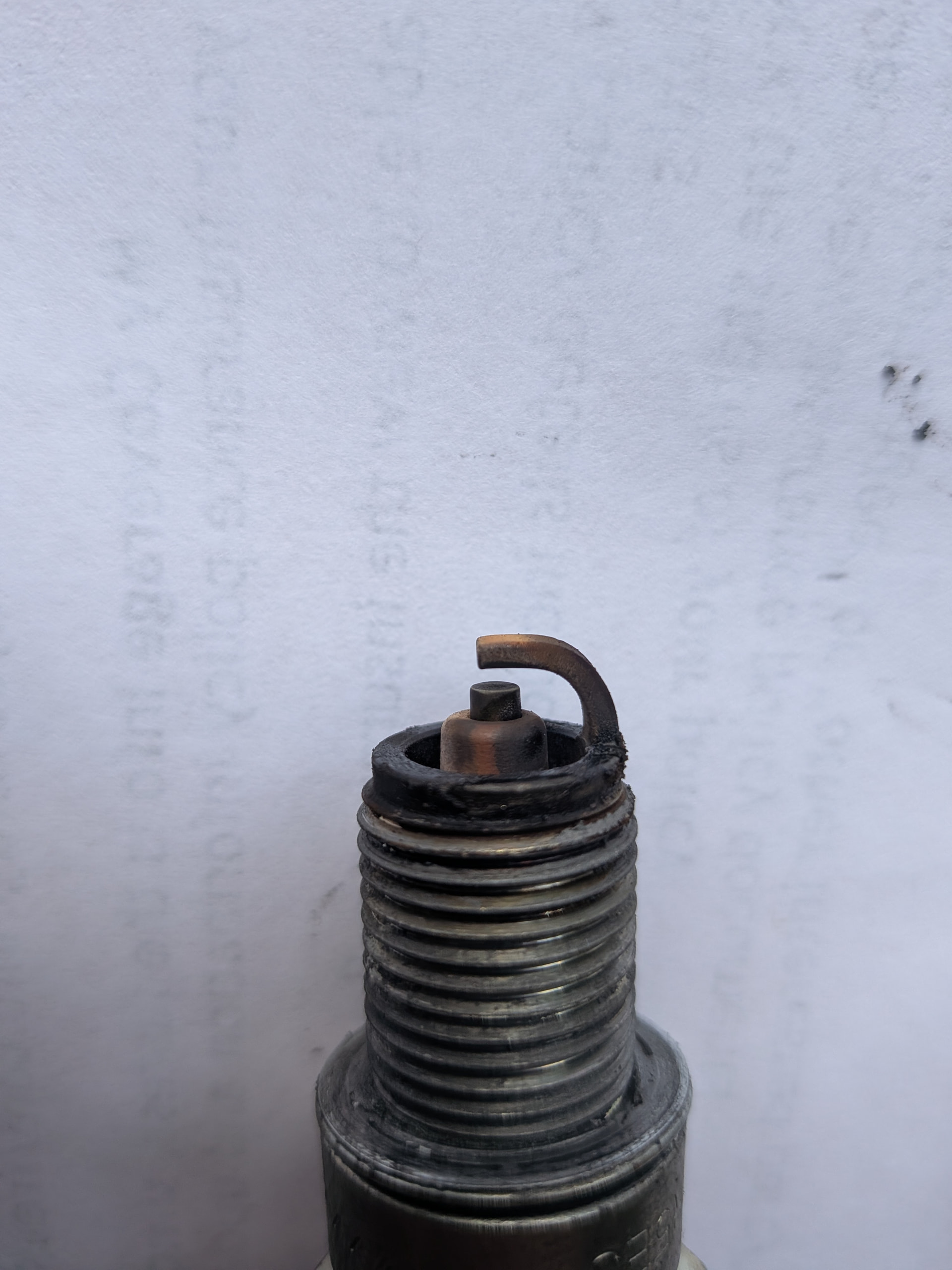

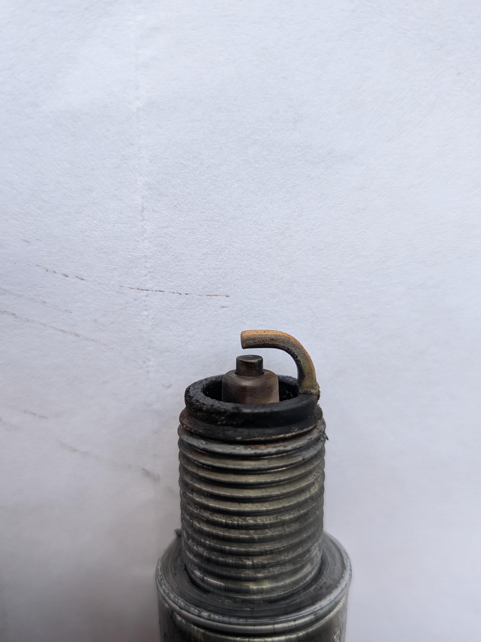

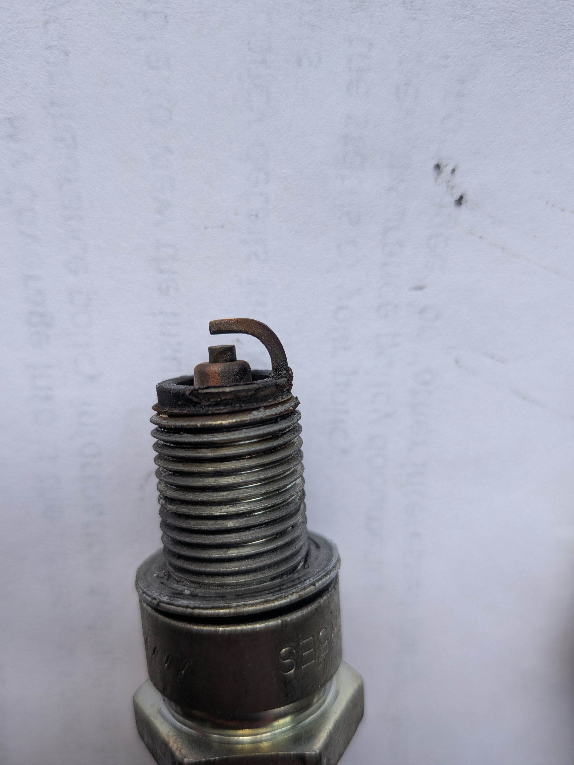

Take 'er out and when she starts acting up, find a place to pull over quick and pull the spark plugs. You can tell a lot by their coloration. You might have one that’s white (running lean), or sooty (rich). Ideally you’ll get a light tan or similar.

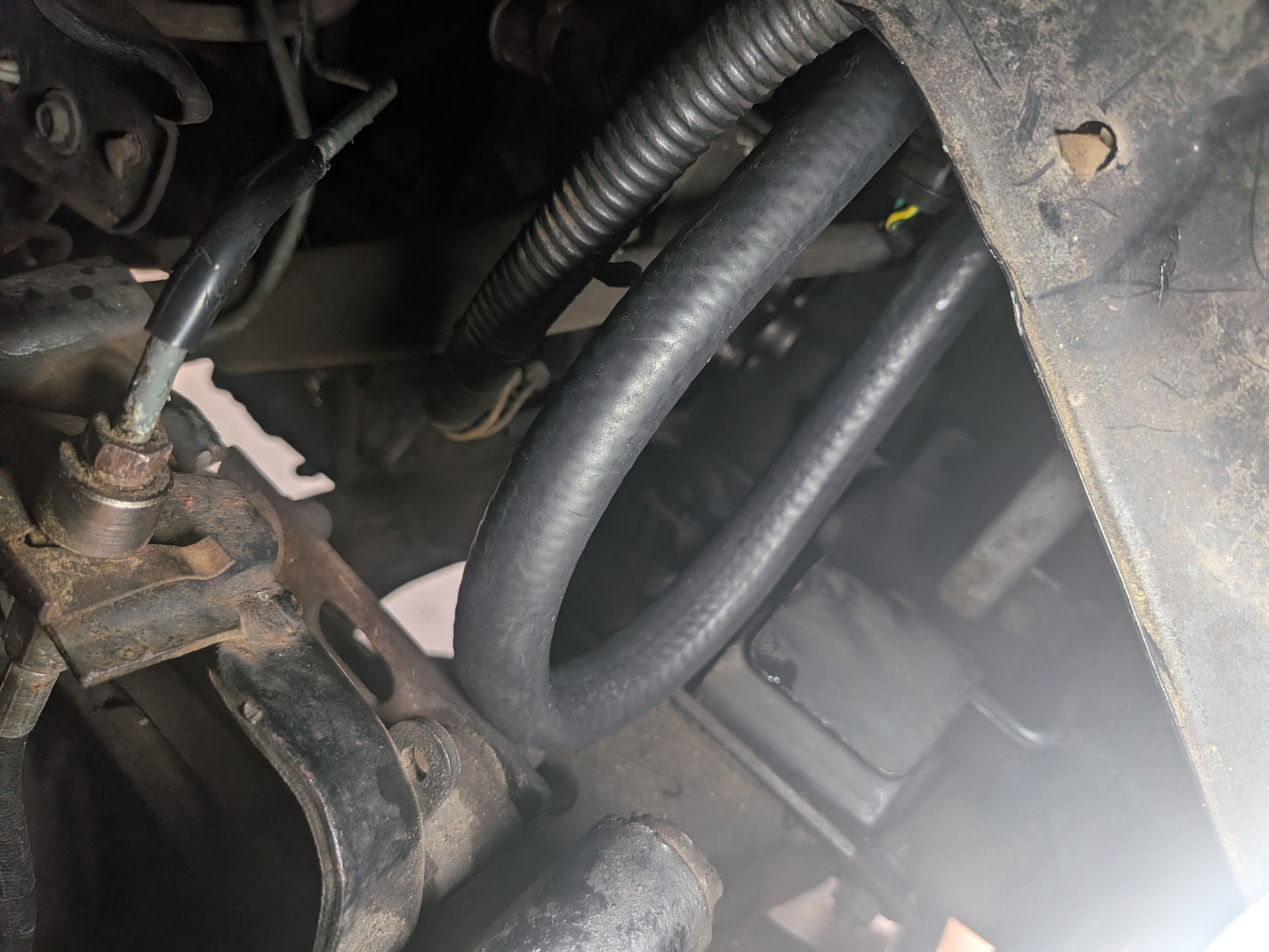

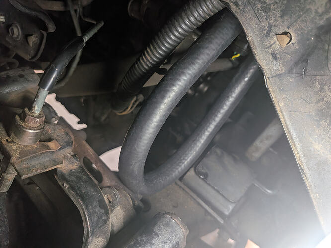

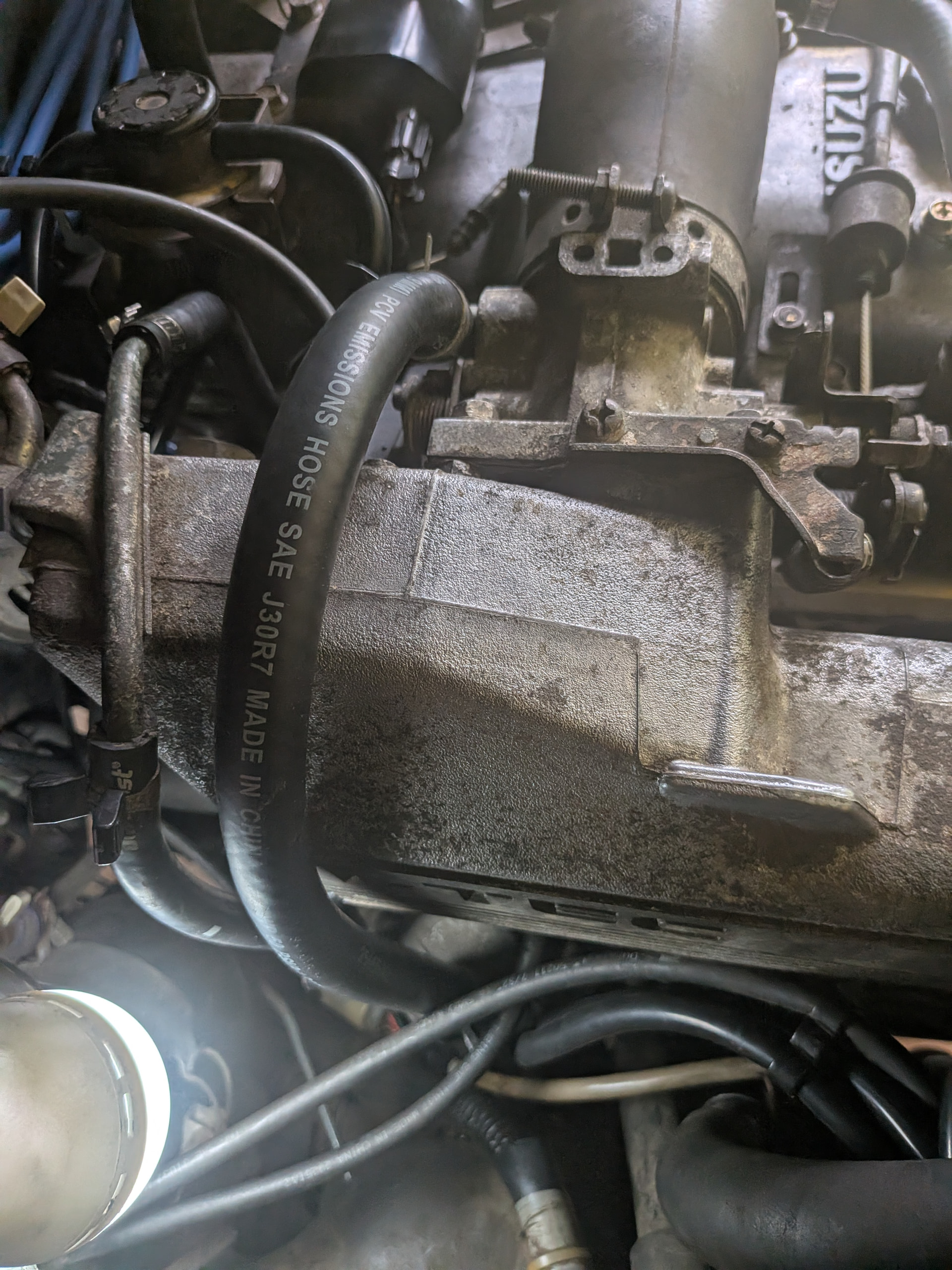

Went out after work and fiddled, looks like the line coming from the bottom of the IAC to the bottom of the intake had partially collapsed. The IAC was relocated to the side of the intake where that bottom bolt is. This forces you to use a longer line which, over time, seems to have weaked and “Creased” preventing full flow.
Looks like a 12.7mm hose and all I had at the house was 11.X, I will run by the parts house tomorrow and grab the correct diameter hose and replace. Hopefully this is the issue.

So it does appear that the IAC is pulling enough vacuum to collapse the hoses I am trying to use.
Can’t tell if the hose is making it he sucking noise or the actual valve unit?
Not sure where else to mount it? Maybe closer to the top ? Best I can see is there will be a hard turn no matter where it’s at?

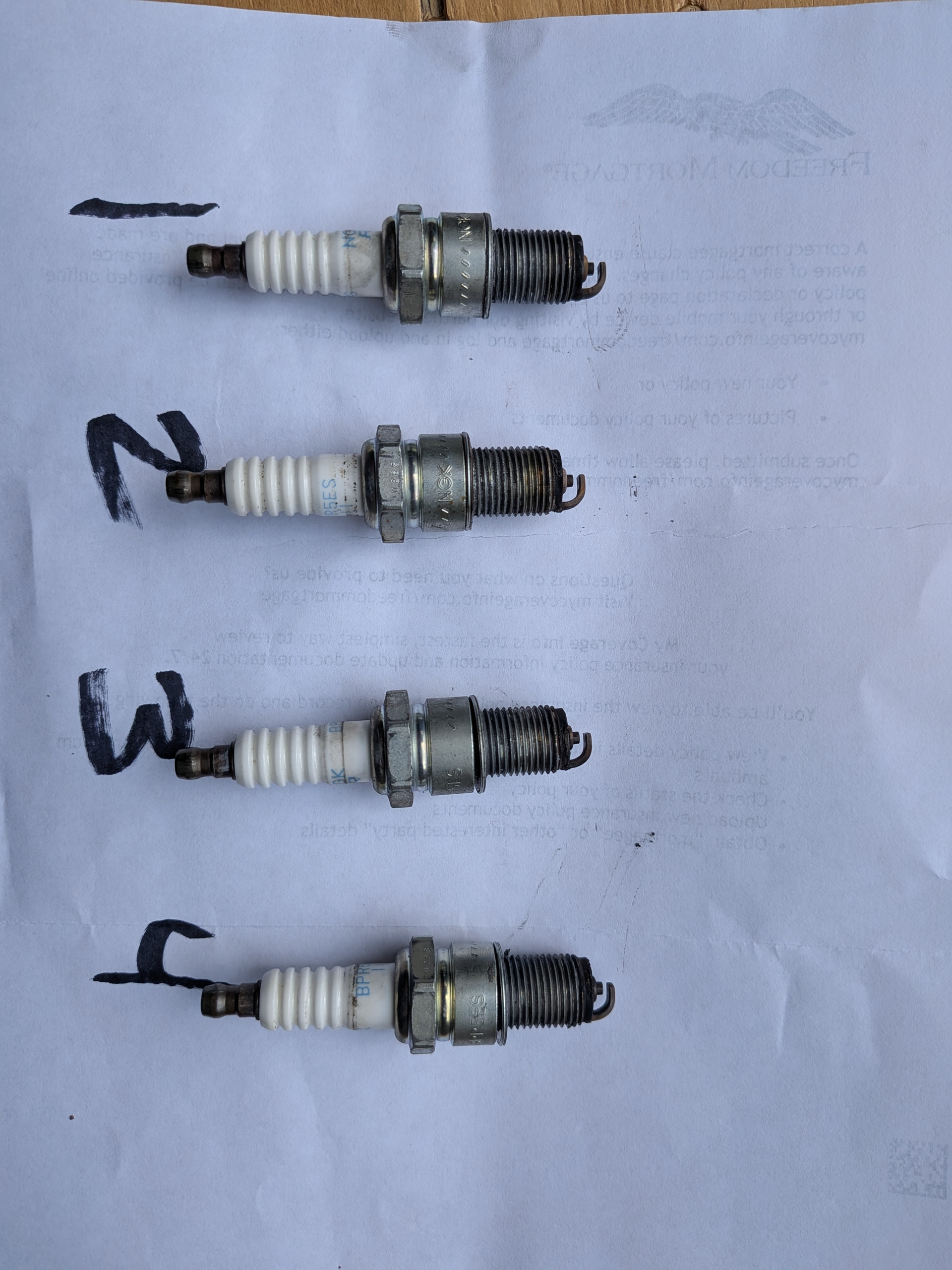

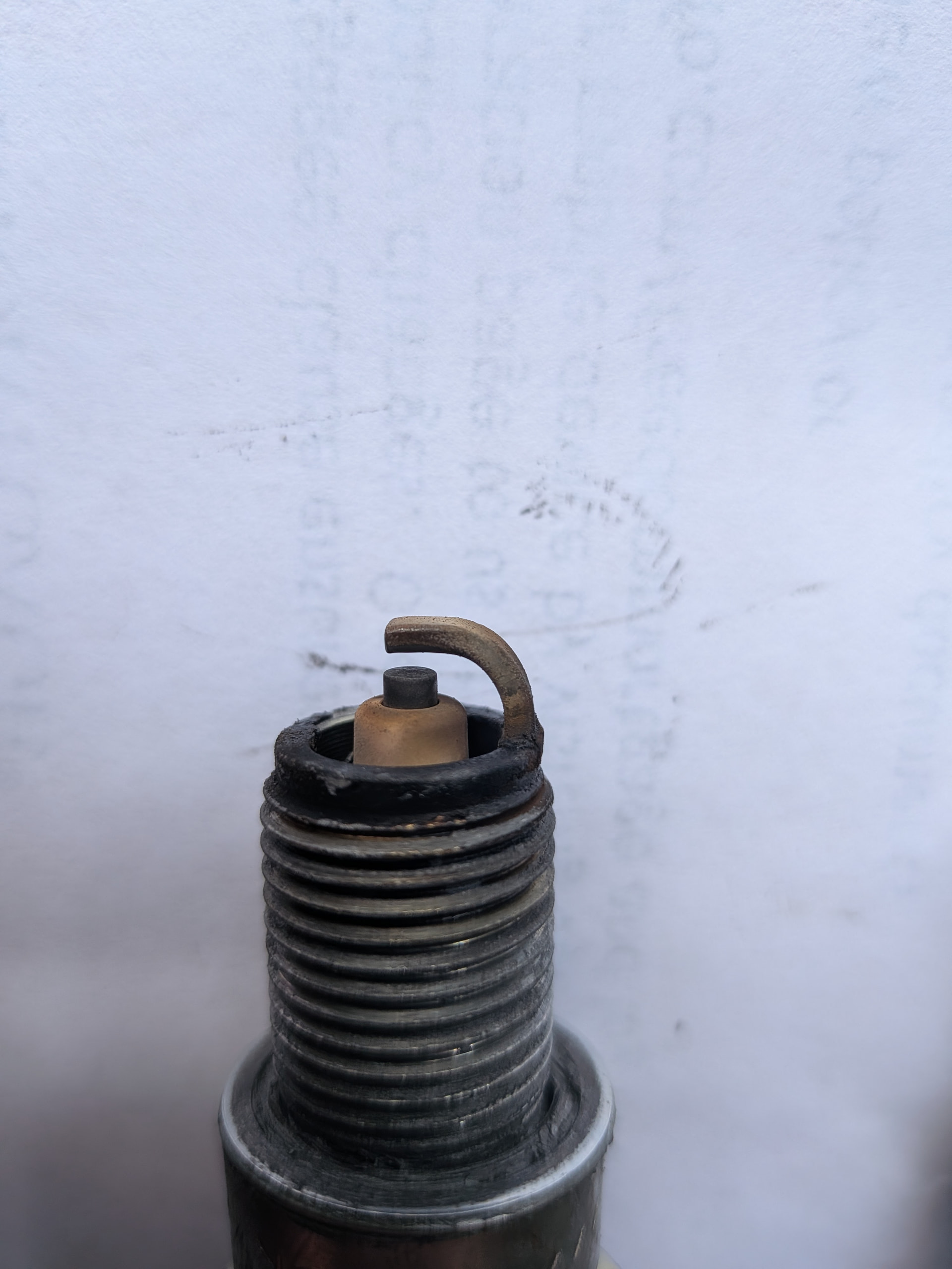

Plugs look fine to me?
Agreed…
Since there is vacuum, is that a reinforced hose to start with? If not, something like heater hose or fuel line may help.
Where there is a hard turn, can you cut the line and use rigid material (plastic or metal piping) to make the bend?
Also, if there is room, doing a partial full circle (that prevents a pinch) with hose can get the job done.
Anything to prevent getting a new chocked-with-electronics vehicle, LOL.
The hose I have is a heater hose, but it still collapses about 90%. I have a rigid vacuum rated hose coming in from chinazon today.
Ill probably also order 2 90’s and do that at the bottom incase that doesnt work.

That is some vacuum to collapse a heater hose that far. Is there an obstruction on the other end that is not letting sufficient air move through the hose?

Not that I can tell, comes straight up and over → IAC → down and back up to the intake.

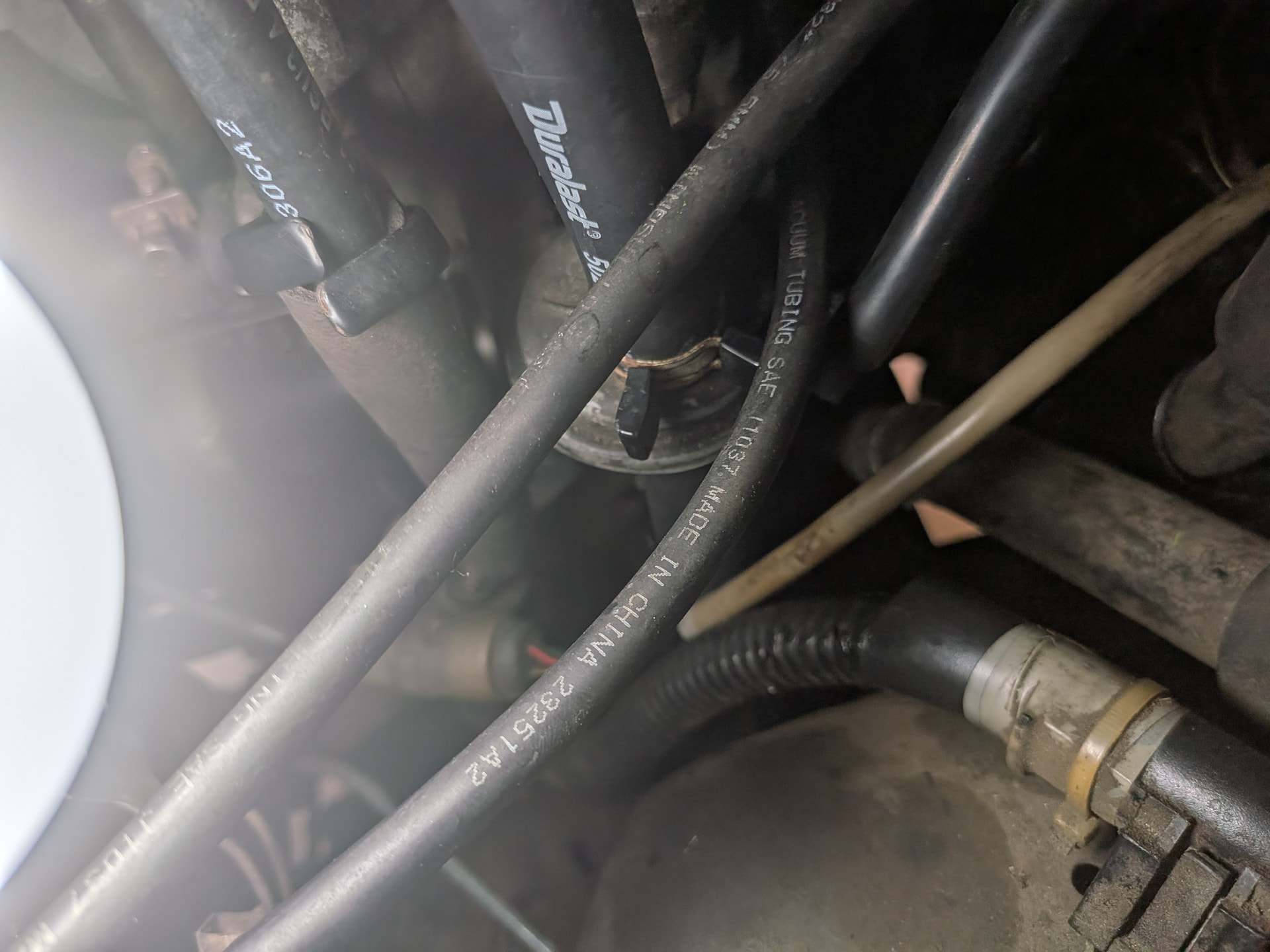

IAC → short piece → 90 → short piece → 90 ->short piece ->intake
That worked, idles gooder now.
