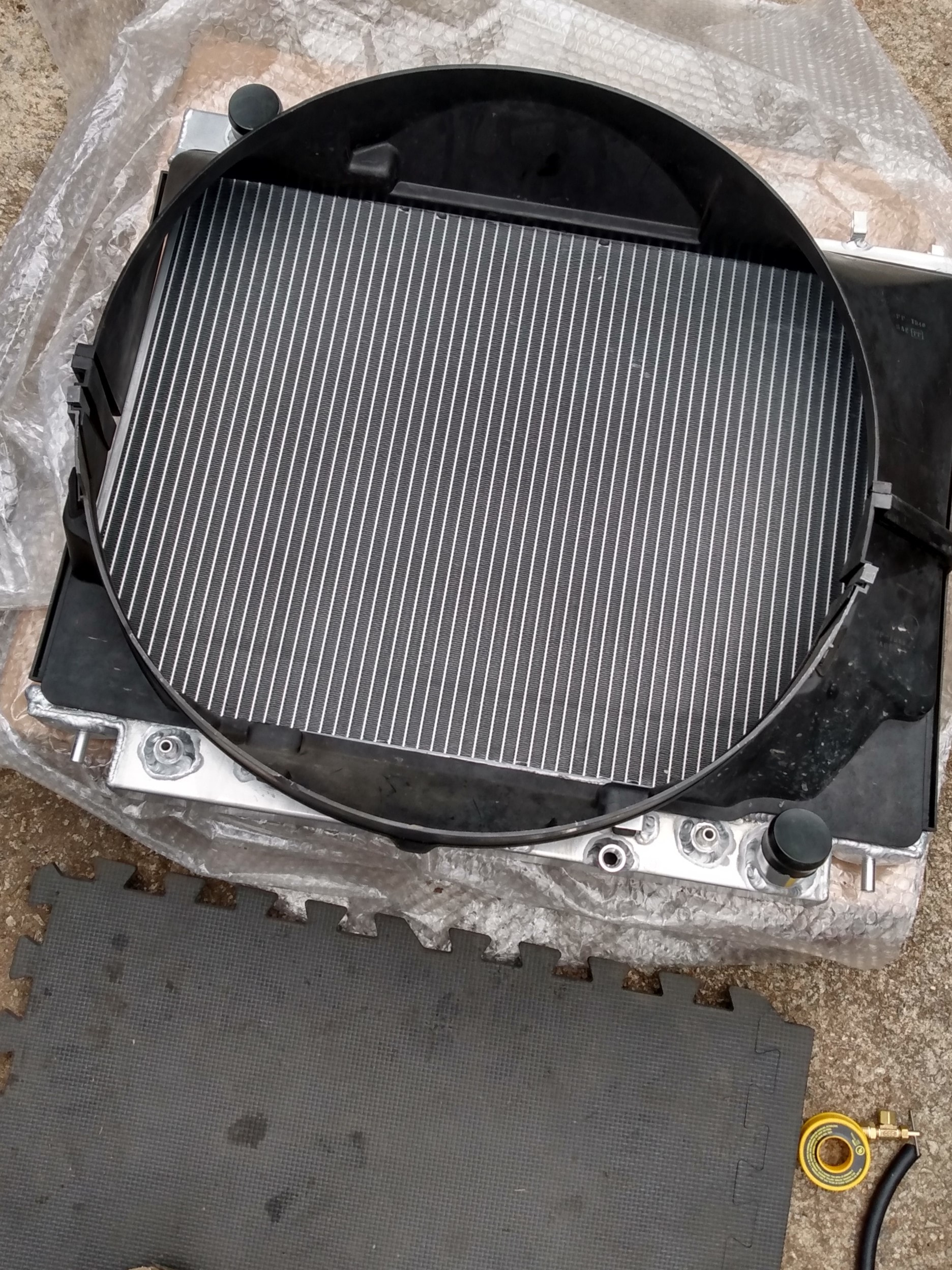

Over the last 2ish months, the radiator developed a crack in the end tank at the top directly below where the rubber flap/seal sit on the core support. This lead to overheating at idle and obviously loss of coolant. A replacement from RockAuto got me back on track, though an important thing to note is there is a change in the middle of the '99 models, if your Rodeo (and I presume Amigo since same-same) was built before October of 1998, it will use the 98-early 99 Radiator and fan shroud. If it was build after October of 1998, it will use the late 99+ Radiator and fan shroud.
The cutoff is somewhere in October as my Rodeo was final assembly in October, and online resources said the transition is for September manufactured radiators (which mine used a 09/98 radiator)
I didn’t know any of those ahead of time, so I used what I thought would fit. Currently my fan shroud is zip-tied to the radiator at the top (bottom slots still fit and work) and will be searching for a new shroud at the junkyard. (The correct radiator will be another $160)

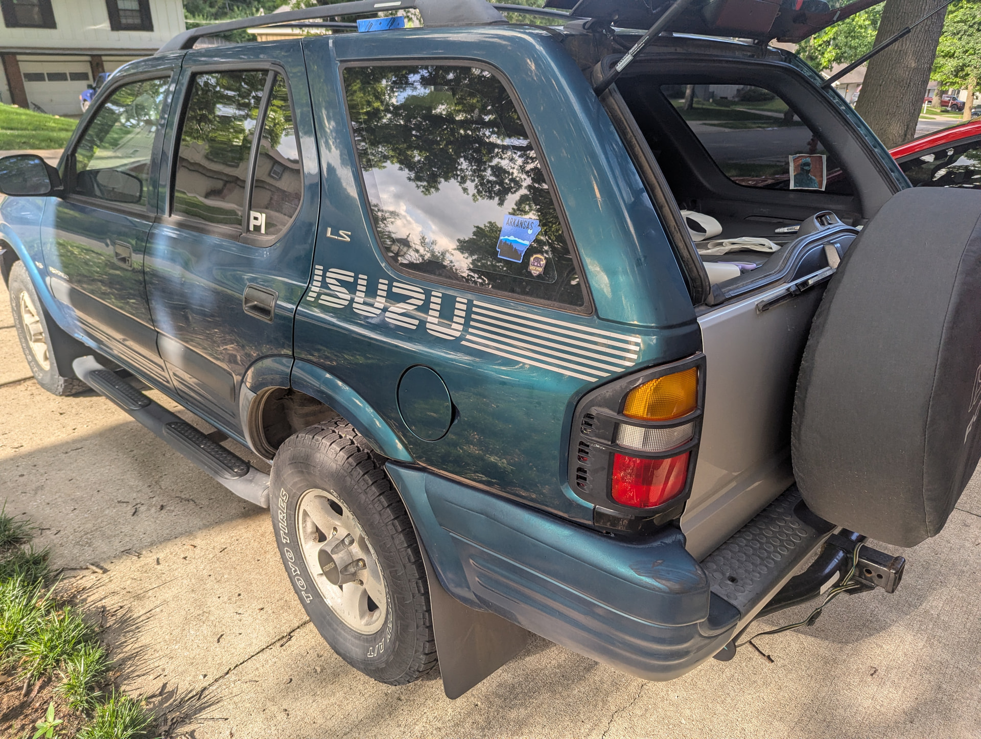

Also a photo dump, I fixed my right taillight brush guard, it fell off in the winter, and re-attached my roof rubber (guards? Feet? Bumpers?) Whatever they’re called.

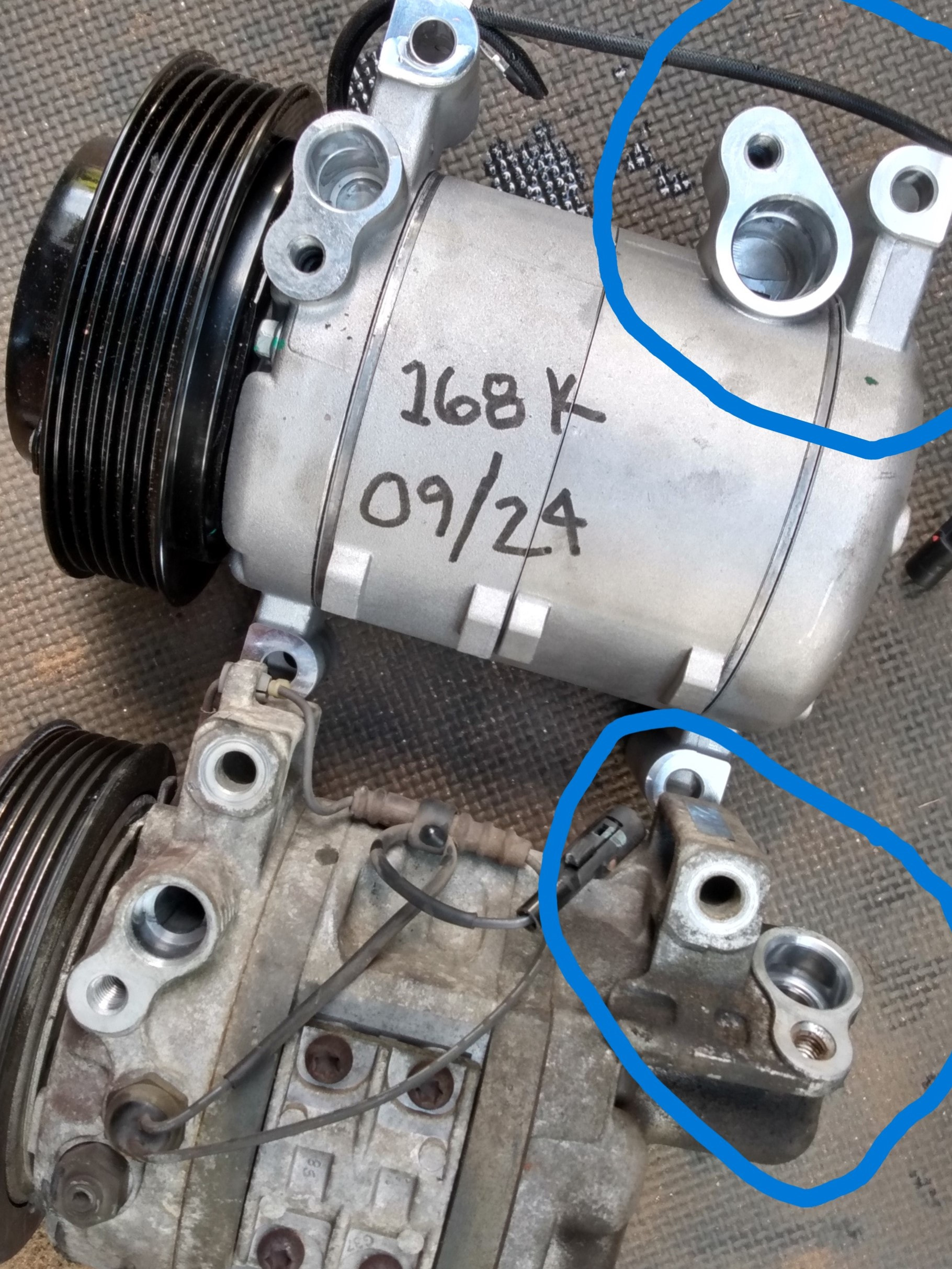

I am aware of the MY changes as I am used to it from other car models I’ve had. I call them ‘cusp cars’. When I rebuilt th A/C system complete in 2024. I did the later compressor which was an upgrade and a little smaller in size. I did have to get the MY 2000 hi/lo lines from the jy which went from the compressor to the firewall evaporator connections. The size had changed. No big deal and the replacement lines were in better shape than the old ones. The system rocks now.
Old vs newer compressor.

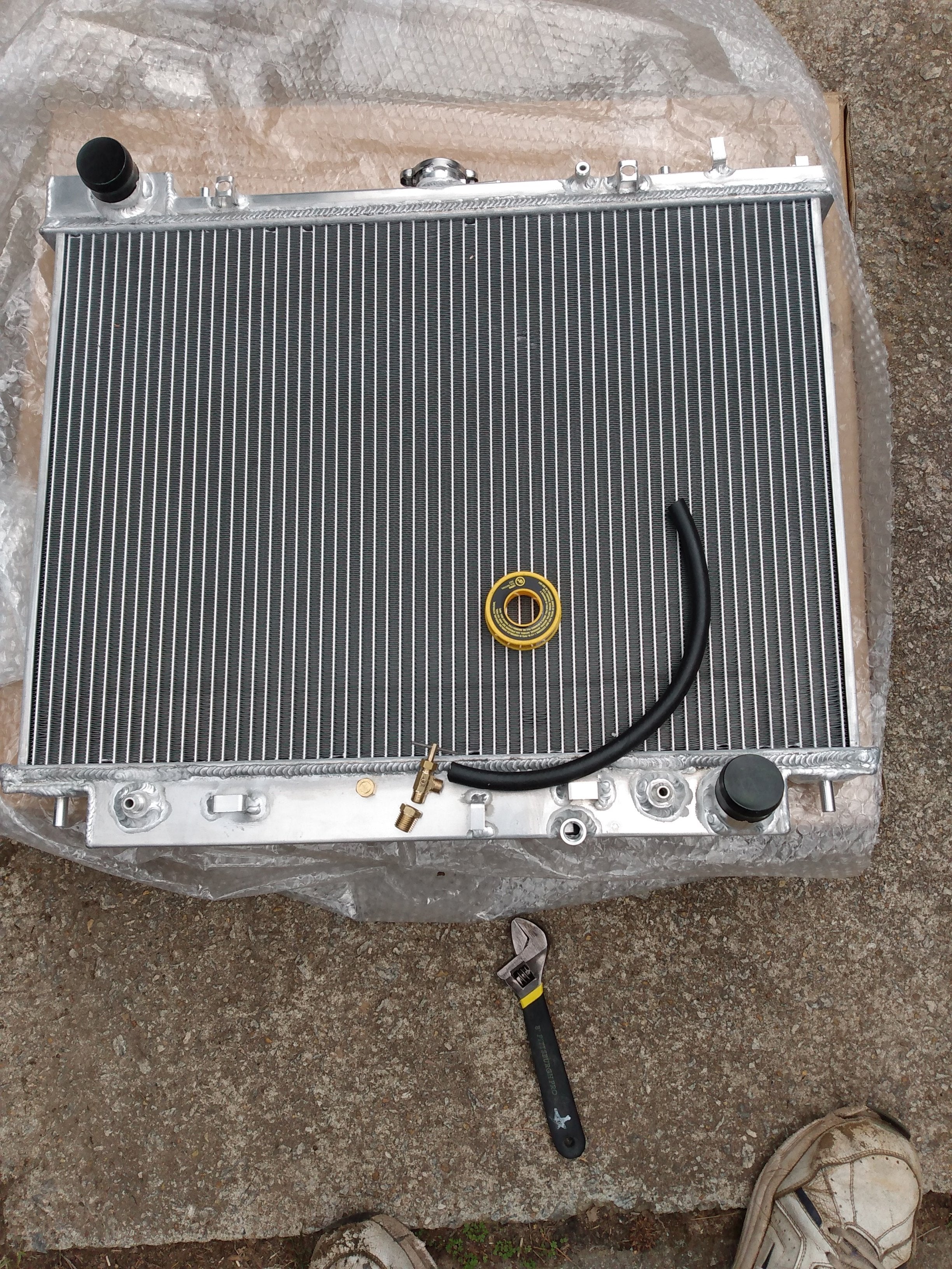

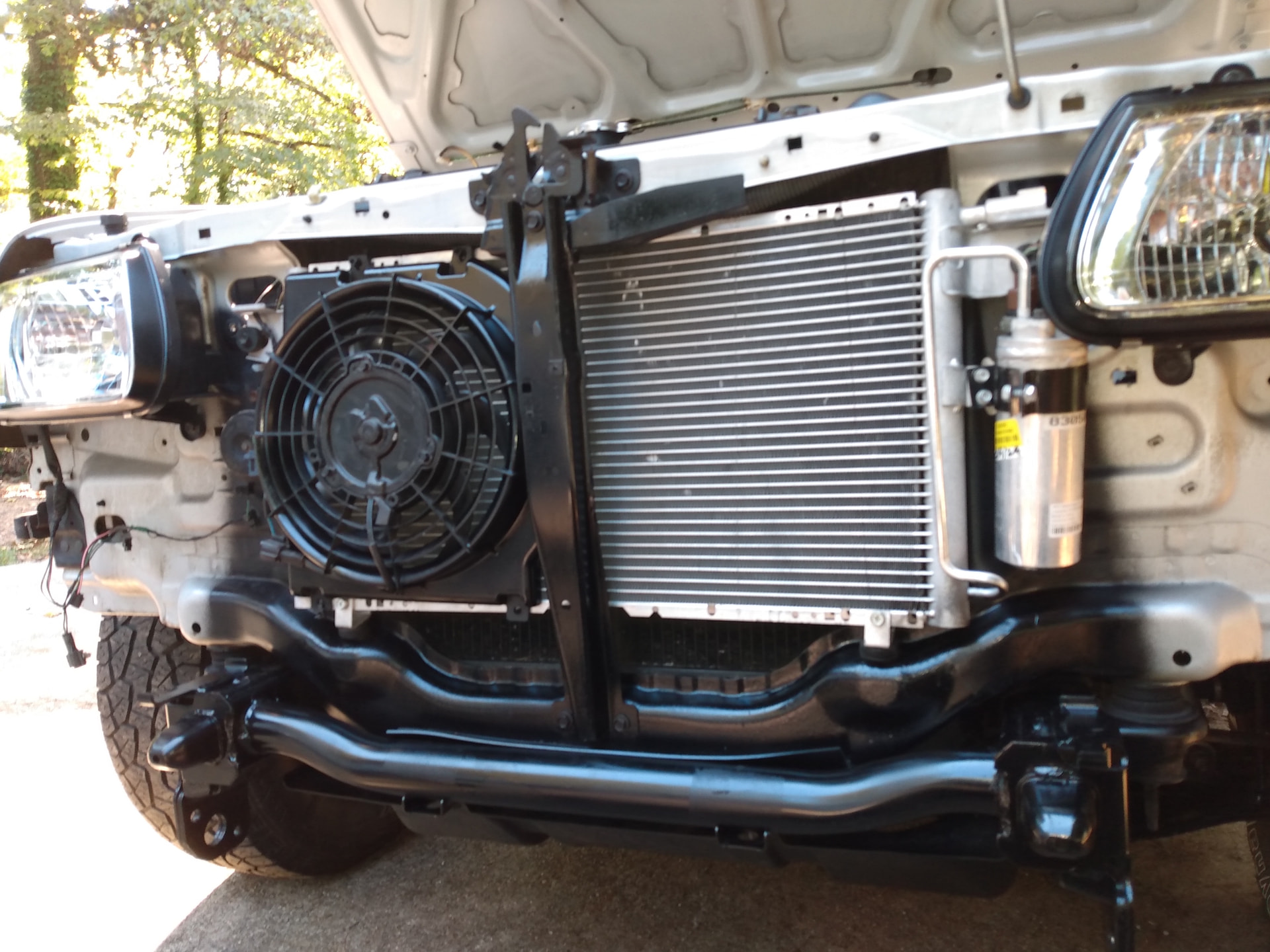

Regarding the radiator, I swapped for a 2 row all aluminum for $160 and this is a regular conversion for me. I don’t have to worry about the plastic any more. There was some slight top screw mount adjustments which I’ve forgotten.

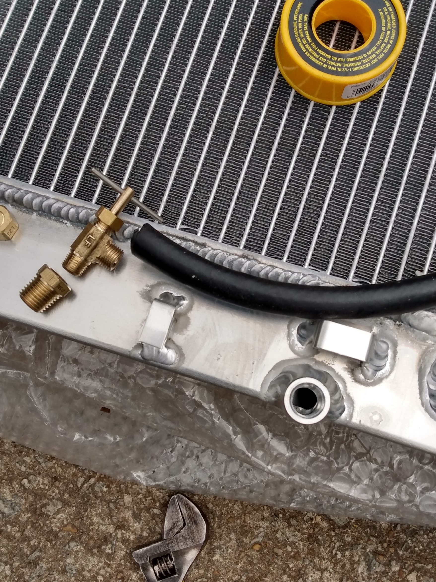

Drain petcock addition. The hose shoves on to the drain and I drop it straight in to the drain pan so no mess. Done this alot.
Where did you get the radiator? And how did you align it/mount it to get the fit correct for the fan? If this rock auto one fails, I know what I’ll be doing next.
Here’s my PI write up with the info.
It fit pretty straight forward with some really minor tweeking regarding the bottom & top mounts and the fan shroud. If you referring to the condensor fan, I added this big one as my manual Rodeo didn’t come with a factory one. I installed it when I did the condensor replacement. If you still have time, return the one to RA. I have had a few issues with their parts supplied.
